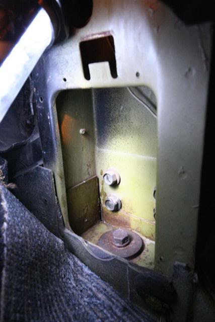

Kent Ved gearkasse ombytning skal du
Indlægaf Lykkemark » 14. jan 2010, 00:05
Kent
Ved gearkasse ombytning skal du være opmærksom på forholdet svejst crossmember kontra boltet.
Diskussionen BB vs smallblock vs stroker 383 er endeløse, noget der nærmer sig en religionskrig.

Kent Du taler gearkasse ombytning. Normalt
Indlægaf Roald #606 » 14. jan 2010, 00:16
Kent
Du taler gearkasse ombytning. Normalt består problemet i at biler leveret med autogear har en svejset travers under sig. Det betyder i sin tur at du ikke kan lave kobling med mindre du er meget lille, eller tandlæge.
Det er omvendt. Crossmemberen er svejst på manuel biler og aftagelige på auto biler. Jeg har jo haft en af hver og det var selvf den med manuel der skulle skiftes gearkasse på....:)

Nej Roald, jeg tror min
Indlægaf Lykkemark » 14. jan 2010, 00:33
Nej Roald, jeg tror min holder lidt vand.
Roald #606
Tilmeldt: 5. apr 2006, 11:32
Indlægaf Roald #606 » 14. jan 2010, 00:40
Nu er jeg nok lidt irriterende men dit eget link siger noget andet
A transmission jack will not help... cannot be used to drop a Muncie out of a C2/C3 with a non-removeable crossmember.
The trans has to be rotated by hand in order to get it to slide back over the crossmember, then tilted down at a 45 angle, rotated, twisted and pulled forward out of the car. It's just one of those things that we have to deal with. The issue is the non-removeable crossmember. If the crossmember could be unbolted and removed, then a transmission jack would work fine. I have a transmission jack.
Automatics had the removeable crossmember.
It was a popular mod to air chisel out the factory crossmember and weld in an aftermarket kit with a removeable center section.
Take a picture of the linkage hook up if you need to.
Most cars with a 4 speed do not have a removable crosshaft so it may be difficult to move the trans back in the tunnel to get the front of the trans to clear the bell housing opening. So you may have to unbolt the bell housing also.
Good time time to check clutch.

Min er født med Automatgear
Indlægaf Claes » 14. jan 2010, 07:43
Min er født med Automatgear - den har boltet aftagelig crossmember. ;-)
Tilmeldt: 27. mar 2007, 23:26
Altså, hi hi, selvfølgelig har
Indlægaf Lykkemark » 14. jan 2010, 09:43
Altså, hi hi, selvfølgelig har du ret Roald, jeg syntes jeg havde skrevet det omvendt. Jeg sender lige mig selv et tæskehold.
