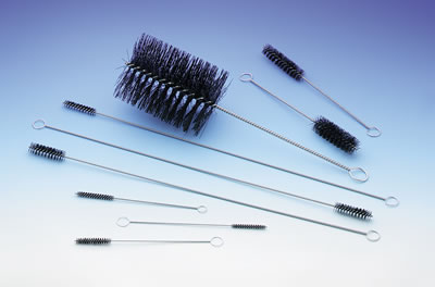

2237
http://www.summitracing.com/parts/MRG-5192/
- mrg-5192.jpg (15.35 KiB) Vist 8011 gange
